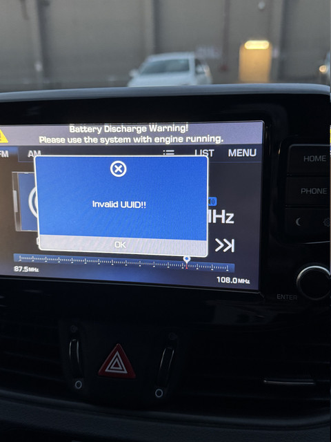

Hello team. Strange issue with my i30 PD 2018. Tonight, got in to go pick up my daughter & screen was blank. It lit up with the splash screen after ~5 minutes. But; could only hear the radio with very low volume, no button worked & it said it couldn’t connect to my iPod. Then a screen with device ID & software/firmware/Micom version appeared - and that was it.
Tried the soft reset & it came back with “Battery discharge warning! Please use the system with engine running”. Then went to the serial screen again.
Was serviced 4 weeks ago. I had driven ~120kms throughout today. Battery was replaced Jan 2024. She’s starting & driving without issue. The only thing I have done is ~2 weeks ago I replaced boot lamp & an interior lamp with LED bulbs as they had both blown. Not sure they could be the issue.
I’ll duck into my local dealer tomorrow but any thoughts & suggestions are welcome.

Update. Hyundai say the system has just failed. They are quoting on a replacement. I’m looking at 3rd party options. Any suggestions on who to look at in Australia are welcome.

Hyundai quoted $1,295 fitted for a replacement. I paid it; this system missing is a pain. I will ask to keep the old one & will send it for repair if need be.
