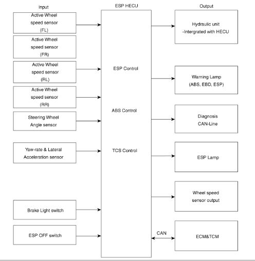

  • I30 Tourer CRDi 1.6
No, I think it exists. My i40 has that icon in the cluster too but I think ESC = TCS + ABS systems.
in over my head a little at the moment. Just no specific section I acn see on ESC
I'm thinking the icon labelled in the schematic of the cluster ESP must be the amber ESC lamp :question:

Thanks tw, looking at the diagrams the ESC and ABS are linked but the ABS is still functioning and have no warning lights for it. With the ABS still functioning it makes me think the 4 wheel sensors are still good, which looking at the diagrams leaves the relays, clutch switch, yaw sensor and steering sensor. I am becoming more tempted to splash out on the knock-off 150e OBD reader and see if it can isolate which input/sensor it is on the ESP HECU.
(The I30 has a separate ABS warning lamp, I felt the ABS kick in this morning when I was trying to trigger it)

Thanks both I think it is increasingly looking like I am going to have to get the codes read with a better ODB reader.
The lack of VSC doesn't bother me massively, it is the first car I have had with it! Was very strange the first time it functioned it felt like something had grabbed the back of the car.
The Orange light is annoying and is an MOT fail in the UK, which is due Sept for this car so need to get it sorted before then.

I guess you read the Charlie8 thread with failed clutch switches?
Offline Spongey
    • Posts: 52
      England
Read it a few times but the symptoms are very different
Charlie8 had
"No lights on at start or driving ( < 50 mph )
ISG stopped working
CC not working - switches on and dash light, but can never set a speed
Clutch down when moving - RPM will drop RAPIDLY ( one of the issues and so bad driving experience on gearchange ) and goto 1K if left, no less. This happens even with no ESC light on ie from start
50 mph ESC light comes on ( whatever gear )
The gear change notification on the computer not working for best mpg"
For me the light is on all the time
ISG - always hit and miss although I think it hasn't functioned in over a year
CC still works
Engine is normal
I get gear change notifications
Which is why I dismissed the clutch switch may have a look if I get chance, from that thread though it appears to be a pain to get at!!
Thanks though I had thought about the clutch switch
