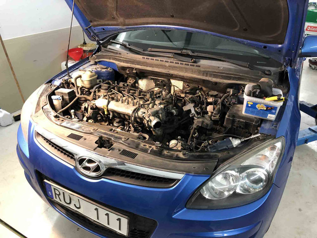

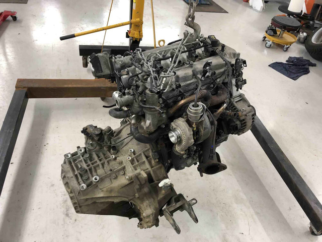

 the engine is done so i went online junkyard order a secondhand engine 2009 .i did the  swap.
however when i receive the engine  obviously i got the diesel engine that has    116bhp .
my old engine only have 90bhp
intake was different , turbo , egr was different. since the head and block is the same i choose to move over everything  from my old engine to the new engine
fitment was no problem every bolton , location  it was the same .
only different was my engine don't have a oil sensor. the used engine had a oil sensor under the oil pan,  but i don't think it can have effect on the swap
now the problem the car won't start. i have bleed the diesel,etc..

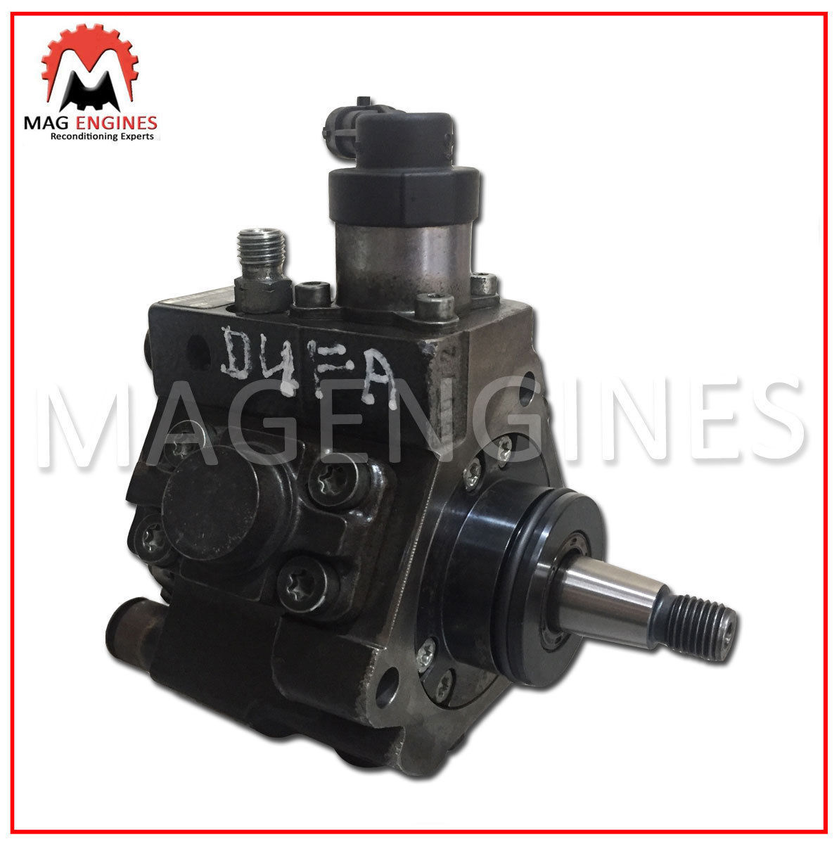

i did compare the high pressure fuel pump both have the same part number from BOSCH.  i moved the fuel pump sensor from the old engine to the new engin. just incase there are something that are different.

In Australia, the early motors (2007-8) had a different fuel rail and fuel pressure sensor set up to the 2008-2009 motor. That was the problem that I initially mentioned. The Euro models (Czech) often dont exactly correspond to ours ( Korean). Your two motors seem  :undecided: to avoid that problem.
While Gerard has the HP pump in mind, I have to ask why do you get the seemingly unrelated code P0341 - camshaft position sensor circuit range /performance - intermittent ?  :undecided:
If you have the same pump , same camshaft ....and now same fuel pressure sensor, why do we have the code?.
Steve, go back , attempt to start, then ( with care  :disapp:)  crack a fuel line either to or from the rail. Do you have 3000psi? We went through this with a guy who was madly priming the pump but was also sucking in air. No start, no pressure.
Regarding the wrecker's ECU, yes you need the immobiliser and key. Immobiliser reads the chip in the key. Then there is a rolling code exchanged between the immob and ECU.

here are the old pic when i started the swap. i will get some new pic tomorrow.
2007-2008 engine
moved everything over to the new engine.
new clutch
  • I30 crdi
Merry Xmas Steve,
Near midday, Dec. 25th . Gerard (tw) is a no show, he will be filling his face all day.  :whistler: :cool:
Your before and after fuel rail pictures MAY clear up a mystery.  :sweating:
Above, the 2nd pic is labeled 2007-2008 , but the rail is hidden and HP pump appears to be later model.
Below is a shot of one of my stock. It is 2010 ( same as 2009). You will see the arrow pointing to the fuel rail that is missing the pressure regulator.  The pressure reg is on the HP pump.
Off duty temporarily.

Nice looking workshop
